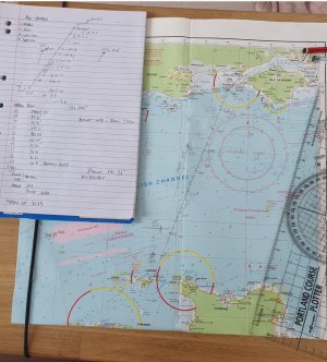

I enjoy the planning part of sailing and come from an aviation background where the 7 Ps are the bedrock.
(Proper Planning and Preparation Prevents Piss Poor Performance).
Last summer I worked up a course to steer from Alderney to the Needles buoy based on channel tides etc and came up with 010M.

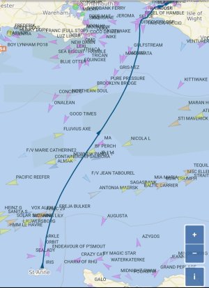

I set that on the autothelm and let nature do it's work. The result was very satisfying.
