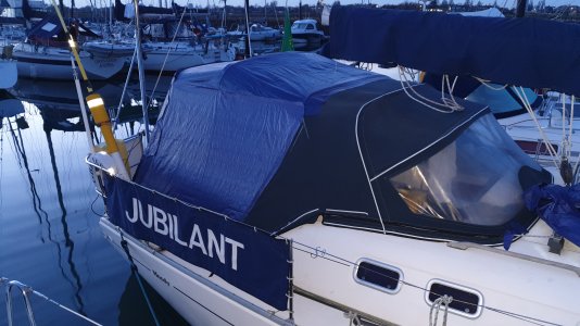

You should end up with something like this for the sprayhood...

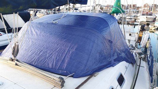

And like this for the tent...
By drawing lines along where all the seams will be, you can then peal the whole lot off and then cut along the lines to get your pattern pieces.
