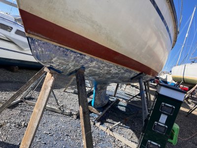

Evening all. Spent today scraping about 30 years worth of antifouling off most of the bottom of my boat. I plan to finish it off tomorrow. My question is, can I slap fresh antifouling onto the hull as it looks now or should I prime the whole underwater surface first and then antifouling?
Snowgoose-1
2 Jun 2015
1,267
I think something like Primocon would be a good idea. It is designed to cling onto both the substrate and the new antifoul.
Alternative is to clean the hull completely and apply multiple epoxy type finishes. It may already have had that treatment at some time. You may be able to tell.
It looks like the ballast keel is encapsulated . If so, no special rust treatment would be required.
