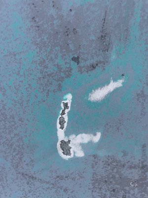

Hello Plevier,
We have just finished stripping old antifouling on a hull with GRP substrate using a paint remover that contains methylene chloride (Attached photo of composition), we noticed very few and small blisters in gel coat so we did some research and we came across your comment here. In most places the existing Gel Shield and gel coat was not affected by the paint remover, however in very few places where gelcoat was exposed and residue of the paint remover stayed for a while we noticed the blisters. What can you advise us to do? can we proceed with local gel coat repair in the damaged places and continue with additional coats of gel shield and new antifouling? or there should be additional steps to take in order to further protect the gel coat even in the places where it's not visibly damaged. We appreciate your response as we're planning on starting the painting process in the coming two days.

I stripped paint off a grp deck using methylene chloride. It softened the gelcoat in places, sufficiently that I removed some of the non-slip surface during scraping. After some time there was no further sign of the softness and it seemed that it was back to its previous hardness. I think I could have repaired it with filler and gelcoat but my plan was to repaint it.
