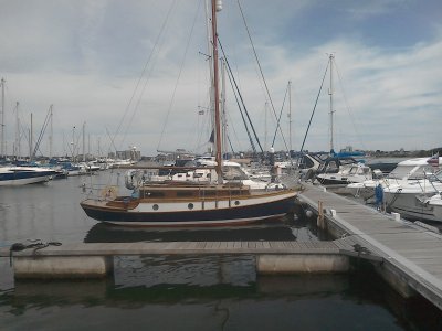

IMG_20190717_171841.jpgToplac 105 blue is good I used it on my Cascover sheathed wooden boat for years. Paint was 9 years old when this photo was taken. Small touch ups suggested no fading.
