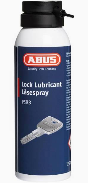

You can still get graphite lock lubricant - it's considered better than oil for locks as it doesn't degrade and gum up the mechanisms. Available online or from a locksmith. Available as powder, or in a liquid spray that evaporates after application.
E.g. (other manufacturers/suppliers available)
