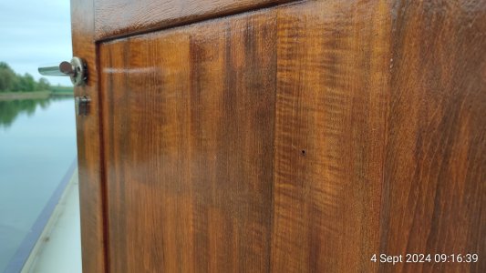

I've decided to use Deks Olie D1 for my teak wheelhouse interior - 4m x 3m with 15 sizeable windows, each with 4 glazing beads.
It is replacing 20 year old 2 component varnish which was allowing water underneath, particularly at the joints. I stripped the old stuff off with a hot air gun and Bahco 650 Ergo scraper, sanded with 60 grit, then 120 grit and de oiled with 2 passes of alcohol.
I then applied D1 to the horizontal panels with a 2" foam roller and brush. Trying to apply D1 on a vertical panel is pretty hopeless.
How many coats should I really aim for??
I put 15/16 coats on the doors wet on wet - 4h30m - as a trial and it is drying out to be quite a thick satin layer. It has penetrated all through the wood and panel joints - and the cylinder locks!!
Other panels were caught by rain after around 6/7 wet on wet coats, so now have water drop damage. My plan is to use fine wire wool to sand and then a couple more coats of D1 just to finish off. Hopefully, the first coats have done sufficient penetration as i realise that there probably won't be more more after the drying has taken place.

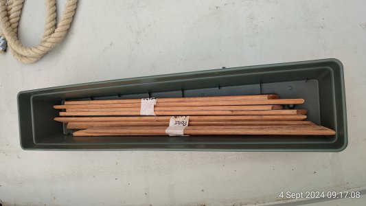

I also have 60 teak glazing beads to do. My idea is to lie them in a rain gutter length/plant window box with lots of D1 to fully soak it up and give them some agitation. How long? ? A few hours? And then stand vertically to drain excess off and dry.
