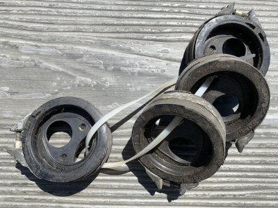

Exhaust restrictors and inlet restrictors are also used I know Suzuki and Yamaha both use those to restrict some engines as well as a remapped ECU to suit the restriction.
My Yamaha motorbike engine was restricted to 80kW where the full power model had 120kW done via restrictor plates in the inlet manifolds and a different ECU.
The restricted inlet manifolds, the whole teardrop shaped centre is open in the unrestricted manifolds.
It's been done for a long time, 1980s DT125 for the UK has max 12bhp but removing the restrictor plate in the exhaust gives you 17bhp, takes a bit more work with the variable exhaust port timing, which was not fitted to the UK DT-125 it's fixed, you can get 21bhp out of it.
The small Suzuki outboards DF9.9B with the removal of the restrictor becomes the DF-15, and then adding the ECU off the DF-20 you get the full power 20hp.
