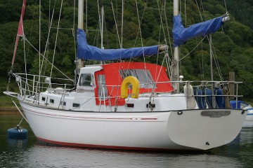

Partly connected with my recent thread on 'keeping cool' we are considering an opening 'window' of some kind at the rear of the after cabin. This should aid the air flow, provide more light and give a view astern.
There is not a good place on the coachroof to the rear of the cabin for a vent.
The rear of the cabin is around 18" high an 4 feet wide, it slopes and has a slight curve across.
Will I be able to fit an opening window here or possibly two circular portlights would be better.
We are not likely to take significant water over this area but would generally sail with them closed in any case.

If this is your boat I would think that a couple (or perhaps just one) of rectangular portlights in that rear "slab" would be ideal. I have fitted Lewmar portlights to three boats over 35 years and never had one leak. The slight curvature would easily be taken up by the mastic bedding. Pick the right ones and site them in line and you will have a very smart addition to the boat.Do the ones in the sides of the stern cabin open? If so, you should get a very nice cross breeze. Rainfall will be a problem but that can be easily sorted by creative use of an inverted inflatable! Don't of course fit a Deck Hatch as these really do need to be on a horizontal surface. Isn't there already one in the roof?

Thanks guys. Yes Chas that is Coral wind! nice pic!!
The curvature accross is quite large, the back portion is about 4 feet across and I measured 4" due to the 'curve' at each end. the radius was consistant across. This implies that there would be up to an inch at each side of a 12" window so I can't see this as being a mastic job!!?
I think, though, that I could possibly make a hardwood pad look reasonable.

Looking at that picture, perhaps two small opening ones would work better. The smaller they are, the less the curvature comes into play.
