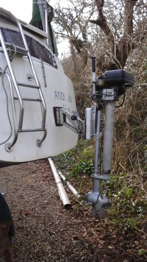

Meanwhile iirc the OP has an old seagull century kicking around at home?
Now, we all know that this will start at the first (or hundred and first) pull and also put out an audible ‘ we are manoeuvring’ sound .. and even a smoke visible tracking trail if you’re lucky
( tongue in cheek, it’s the perfect simple motor for what the OP has in mind ). And no one Is going to nick it
