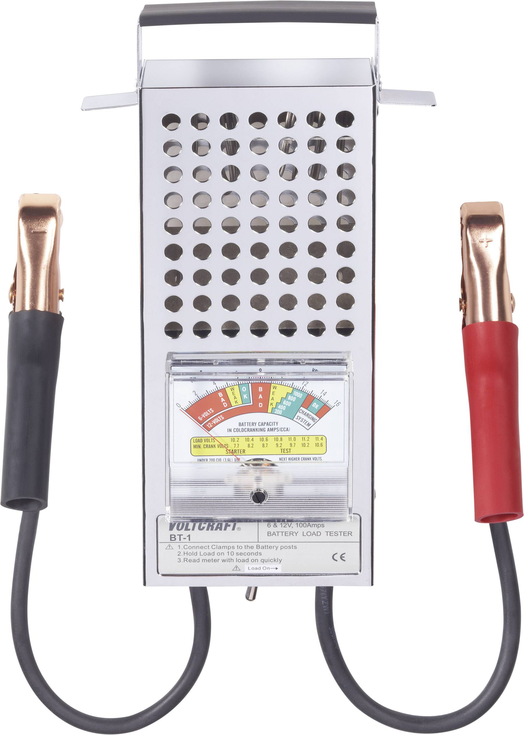

Do the right thing and disconnect both batteries, then fully charge them individually and measure the voltage. Leave them for 24 hours, re check the voltage to know how much they drop when not connected. Then load test them.
Replace any that is not ok with a new, specifically designed for each use (start / domestic). Get the biggest you can fit/afford, meeting or exceeding the engine manufacturer's requirement for start battery..
C'mon.
