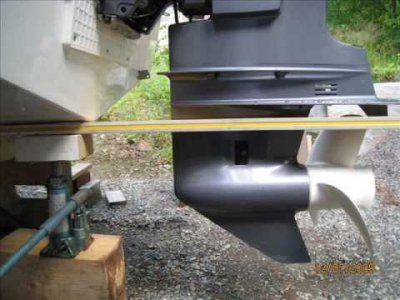

It would be unusual to have a power trim facility on a 280 drive. The trim on a standard 280 drive is adjusted on the tilt pin, from memory there are 4 or 5 positions
The drive has a lifting facility via an eletro /mechanic lift motor and ram which will be forced closed if fwd drive is applied (hope my memory is correct here).
You could also purchase a version of the drive that had external hydraulic trim rams mounted in large housings either side of the sterndrive, Yours does not appear to have these in your photograph.
If yours is the standard drive the best way to set up is to do several runs with the tilt pin in different position until you find the positon that achieves the highest speed, you can then use the trim tabbs to assist the hull onto the plane.and then use the tabbs for leveling port and stb

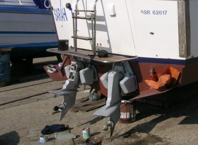

The outdrive 280 with the T & T capability was the 280 T.
The leg was lowered and raised and trimmed by a a pair of hydraulic rams and not the electric motor from the wifes Electrolux vacuum cleaner.
These rams were dual purpose as the they also worked exceptionally well as quick dissolve anodes.
280T was Volvos neat way of testing out a hydraulic tilt and trim system on the unsuspecting public in the dog days of the 280 before introducing the ultra reliable virtually requiring no maintaince or servicing 290 series... with added more up to date grief designed in.
The little alloy castings behind which the almost constantly weeping hydraulic rams lurked , made the most attractive and cosy home for any barnycules within swimming distance on the south eastern coast.
It was of course almost impossible to get in there and clear all of them them out of course.
Many died a painful and lingering death after a thick coat of that stuff in the tiny weeny tin of expensive "special for outdrives goo" was slapped over the top of them.
The little tilt and trim calibration device on the steering hood to let you know what angle the legs were at sometimes worked for whole weeks before giving up.
Please note the little unpainted 1" gap between the transom assembly casting and the hull anti fouling.
This allegedly was to stop any reaction between the aluminium assembly and ones anti foul.
Thank your lucky stars outdrives are so much easier to sort these days.

I found the books (all in Swedish though) ... the 280 drive - basically a later 270 ... has three pin positions .. the middle one being the norm.
How you actually change the pin position in water ??? The pin is well below waterline.

Yes I had alot of experience on finding best trim pin position and as l describe earlier was the best solution.
I did have the benefit of a crane and a slipway!
How does the boat run now.
Does it plane easily and run slightly bow up. Does it achieve max revs
If all as above trim pin is in correct position
Boat needs to be out of the water or you need to under the water to adjust trim pin!

The trim does the same on a sterndrive and an outboard - with the difference that outboards can be fitted higher on the transom. Volvo decided where to fit your driveline, so that is a fixed parameter.
Trimming IN (leg closer to the transom) will use engine HP to lift the stern (pushing the bow down). As does pushing trimflaps down.
And vice versa.
Another notable difference is the trimflaps' ability to righten the boat if load is not evenly distributed SB <-> BB. The same goes for side wind when on the plane as wind will push the boat to one side and you'll countersteer to keep the course. A deep (-ish) hull will lean "into the turn" hence tend to list notably when going straight in a side wind. Using one side's trim will help this annoying behavior.
With a fixed trim (pins), you aim "for parallel with the keel line" as a starting point and leave it there until tests have told you how it operates with this and your trimflaps. If good, no need to change.
