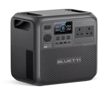

I am thinking about off grid power and am looking at the Bluetti or similar. The obvious solution is an inverter but I am not battery ready for that yet. I am thinking about the 2000w versions so we can easily run kettles and a microwave whilst at anchor which we want to do a lot this summer in the Baltic. These can be easily charges up when in a marina. Does anyone use one of these and what sort of feedback?

I bought the Bluetti Elite 200 V2. From the one season I have used it the capacity and performance have been as expected.

It will not do what you say you want to do in post #1, the battery is far too small.
Mine works a 1500w kettle, a Toaster, the Air Fryer, An Instant Pot, a corded handheld Vacuum cleaner, corded power tools-including a BIG hammer drill needed to bore a six inch slab of concrete for a security ground anchor and anything else below 2,000w for a short time.
Obviously not all at the same time!
None are used for long periods-just as long for the toast to cook, the kettle to boil or the job to be done. Not tried a Microwave, so not direct experience there.
Well pleased so far. Last Tuesday after some use it dropped to 61% charge. I plugged the 12V feed from a cigar lighter socket, it was at 100% 2.5 hours later, engine at idle. The engine was not running just to charge the bluetti.

Not saying they are no good, they certainly seem to work for some people/circumstances. But, the OP says "so we can easily run kettles and a microwave whilst at anchor which we want to do a lot this summer in the Baltic"
Is the AC180 suitable for that ? I don't think it is.

‘A lot’ and ‘at anchor’ certainly sounds as if he’ll exceed it’s capabilities. The trick is to have a decent stab at working out your daily needs, and your maximum current. Then bear in mind your solar panels will be at 10% in heavy cloud. You need quite a lot, and you probably need 2 days power in your battery, to live at anchor.
For about three years we ran everything off a 270Ah battery, so nearly three times the capacity of the Bluetti. This did all our basic domestic loads including cooking. But there wasn't a lot of spare capacity there- one cloudy day and we had to turn the gas back on.
We upgraded to 550Ah and it made a huge difference, giving us a day in reserve.
For this season we are upgrading to 1111Ah, or nearly the equivalent of twelve Bluetti units.
