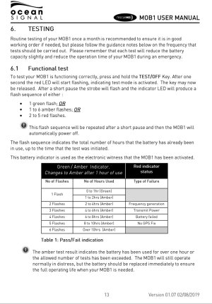

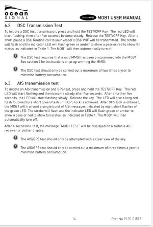

The manual suggests there is a separate test for a DSC Transmission test...
From that, I'd assume the "functional test" doesn't actually send an AIS Man Overboard alert but that the DSC Transmission Test does.

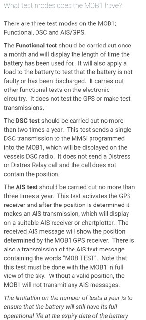

Although the manual doesn't make it clear what each test does, the online product FAQ does.
MOB1 - Ocean Signal

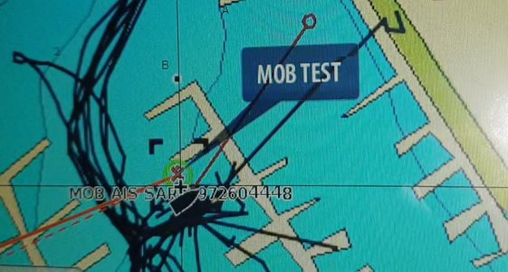

One thing I noticed was that the AIS position did appear on the chart plotter but was just a position during the test. Maybe I didn't leave the video running long enough to see a test message, but I do know from experience that in a real MOB situation, the B&G zeus does add the MOB message to the position indicator (although maybe that's from the DSC message).

I did then try the AIS test on one MOB1 at the chart table and on another at the helm..
The test at the chart table did get a GPS fix and the MOB showed on the plotter but was about 50metres out of position.
The test done at the helm, (as you can see in the video) showed the position as being right next to the boat.
Bearing in mind the instructions do say the AIS test needs to be done with a clear view of the sky, this was expected.

The video I took (and the instructions above) show that the DSC test does not include any requirement for a GPS fix.
It's only the AIS test that waits for the GPS fix before sending the AIS MOB TEST distress message.
