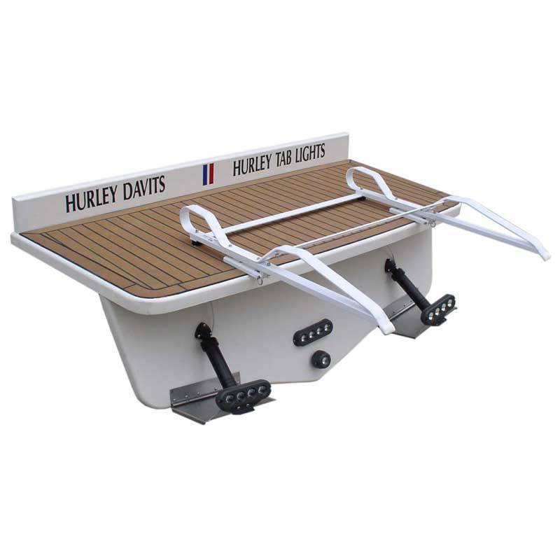

Hi, Yes. I have something that could resolve your issue. The original Hurley Davit, no longer available. The spacer bars between the two arms are not essential and can be removed so they sit either side of the engine and are extended out on SS square tubing behind the OB motor. Because this will then act as a lever I would not have anything more than a 12 kilo 3hp 2stroke on the back of the tender or you will have to remove the OB. I have a pair in the back of my Land Rover if interested pm me.
Hurley Traditional Dinghy Davit System - Hurley Marine
Ah, you are new, you may not be able to pm me until you have a couple posts under your belt. No worries. Like my Land Rover the davits are not going anywhere.

If the tender is light enough why up and over the outboard? Which you could still do with a Hurley system on a Heath Robinson scissor lift system using gas struts, but if the steel rail for the Hurley davit was placed at enough angle to clear the water on the dinghy far side then just keep the entire dinghy behind the motor. The whole point to this exercise is to make it as easy and convenient to launch and retrieve the tender as possible. The Hurley can also unclip from the rail for marina berthing.
