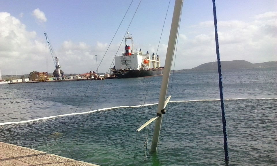

No charter boats. Just spoke to the guy, he said it hit his mast! Out of the 4 privately owned boats on this side his was the biggest (47ft) so I assume that's why his last got hit. Shame as its day one of his 6 week holiday.
But as you say no one was hurt.
