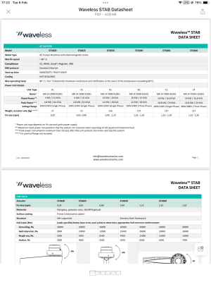

My brother in law in Phuket is buying a Nordhvn 51 and needs advice on stabilisers. It looks like between CMC & Humphrey’s.
i am told that we should be able to install electric Stabilizers on board your N 51. Drew has provided two manufacturers that we could use, CMC and Humphree. See the attachment for the CMC’s and the link below for the Humphree. Also, per Drew’s comments below, he estimates the CMC up charge would be about $ 25,000 more and the Humphree could be and additional $ 10,000 to $ 15,000 above that. Please let us know if you have a preference as to which stabilizer manufacturer you would like to
Here is CMC. I don’t know what model Humphries we would use. I need to get that from the yard.
Humphree website: https://humphree.com/boat-fins-and-stabilizers/
