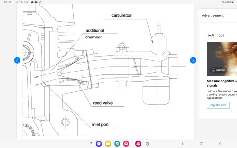

Normally called a Reed valve if the engine is 2 stroke. Thought that they were between the fuel pump and engine or even part of the fuel pump. Never had a problem with this part on the yamaha malta's that I can remember.
Reed valves in two-stroke engines have been placed in the intake ports and also in controlling the intake to the crankshaft space.
