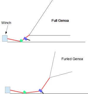

OK you have a block situated to sheet the full genoa. (set block. Green)
You need something to properly sheet a furled/reefed genoa.
How about a frictionless ring fitted with a soft shackle that is floating between the set block and the clew?
Or even two?
Of course this is set up on both sides.
In the illustration the Light green is the set block and the blue is the floating (fitted but not set) frictionless ring.
