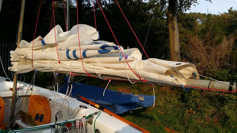

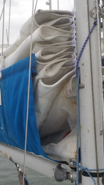

While I'm asking, is there any reason not to replace my lazyjacks with a Dutchman reefing system (home-made, like the lazyjacks)?
The lazyjacks have been great but not perfect, and they add a lot of line. I'm sewing track sliders onto the luff to make the sail easier to hoist and drop. With Dutchman reefing, I'm hoping I can release the halyard and the sail will flake tidily on the boom with minimum encouragement, assisted by gravity.
The lazyjacks have been 100% better than having the whole lowered mainsail (and unsupported boom) loose and flapping in the cockpit, but the sail doesn't flake on the boom without a lot of help that I'm not free to give (I single-hand), leaving it as a mess caught between the lazyjack lines.
Dutchman reefing looks ingenious and pleasingly simple, but seems to be extremely rare. Is there some downside that explains its unpopularity? I can't even find one good photo of a system to illustrate my plan here.
Here is a link to a description of the Dutchman sail flaking system that may help,with a few pictures:
The Dutchman — UK Sailmakers
I made a lazy jack system that looked much like the one in your photos, but it ended up tangled in the mainsail once too often, so I got rid of it. Having to stow it prior to raising the sail and then hoisting it again before lowering the mainsail rather defeated the purpose of making sail handling more expedient for a single hander.

We prefer our Dutchman system over the stackpack/lazy jacks on our previous boat, but as Daydream Believer says, if you are taking the sails off after each sail, you will spend a huge amount of time rethreading the Dutchman lines up through the sail again.

PS. I would stick with you lazy jacks - threaded ropes does sound like a real phaff to rig and I rig, and must either be too slack or will impact sail shape.

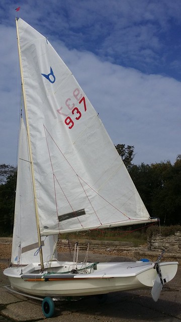

Regarding the possibility of the Hood sail coming from a different class, I offer the photo below which includes the Osprey insignia. Not absolutely conclusive, but it may show that this sail is from the era before the class used a tack downhaul cringle.
I certainly can't be sure the sail is younger than the hull. If both are from 1973, I can believe that as suggested, that sail's fittings precede common installation of a tack-downhaul.

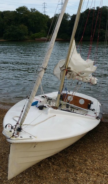

...but the last photo in my first post, reminds me that the lazyjacks keep the lowered sail above the boom (somewhat untidily) whereas the flakes enabled by a Dutchman system would hang below the boom, where headroom is limited anyway.
It wouldn't concern ordinary Osprey sailors who almost exclusively race two-up, but I use yacht-style adaptations to cruise the boat single-handed, with a degree of control that her size and original design didn't allow for.
I've sometimes flaked the sail in the lazyjacks as in the photos below, but that's not the way they fall naturally, and making them so neat isn't easy whilst afloat...
...I'm embarrassed to say after long years happily using the lazyjacks, I only just realised they are meant to be used with a topping lift. My lazyjacks support the considerable weight of my boom, so the the tight lines constrict the sail in a three-inch-wide space, which prohibits all hope of natural flaking or settling of the sail.
On that basis, perhaps I want a topping lift instead of Dutchman reefing. It'll certainly be easier to add. (y)
The Dutchman system still needs a topping lift, as the lines are suspended vertically from it. The lines come from the topping lift to the boom so the sail sits on top of the boom & only hangs down a bit. Certainly no more than your current system, because if done properly the line zig zags through the sail & it drops to the top of the boom. If the lines are too slack the sail will not drop properly
Indeed, but that's what I mean...as I have to fit a topping lift, I won't need the Dutchman because the LJ lines won't squeeze the sail...
...but if I'm not content when the sail has space to sit flattish between the LJs, I'll be part-way through making the Dutchman anyway.
Useful photo of the sail - though needs a bit more wind to see the shape properly.
The shape of the leech does make it look as though it probably is designed for an Osprey.
But it does look quite full in shape - and certainly the luff will need a LOT more tension to be sailable upwind in a breeze (though perhaps a heavy dose of kicker to bend the mast might help in a wind).
I am no expert on Ospreys, but around our area they didn’t have any GRP decked Ospreys in the early 70s - seem to recall mostly wooden and a few composite (GRP hull with wooden deck). Suspect a knowledgable person could identify the generation of Osprey (certainly not a recent one, based on rear tank).
If the sail is 50 years old I would expect you could tell by the cloth and stitching. Either way, unless your gooseneck is on a slider, I would think it needs a cunningham eye added.

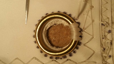

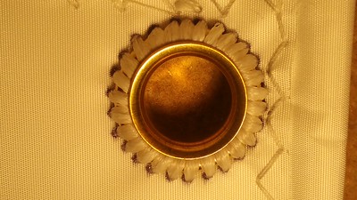

Perfect, that block is indeed for the Cunningham. The main tack crinkle will need a repair though, as the eyelet has pulled out (must have suffered some abuse for that to happen as one thing Hood sails generally were was robust).
To repair that hole I would not bother with a sail maker. I would get a piece of UV resistent webbing 25 mm wide 200mm long & place it folded so it is each side of the sail by 100mm. Thus leaving a small loop at the corner. You could trap a small ring in the loop but a cord long enough for a tie down or a long dynema shackle would be neatest. Necessary because you have a broken gooseneck so you have to tie to the mast. Stitch the webbing through the sail for the 100mm to itself ( Bisecting the angle) & you are good to go. You will not put massive pull on the outhaul & you can always keep a little tension on the cunningham to prevent the halyard ripping it out if you do not feel totally confident in your work.
A sail stitcher- if you do not have one already- is a useful piece of kit to have in ones armoury of rigging kit.
Thanks DB, actually my sail-repair bag grows by the year and I think I have the right kit. I've previously used rings and turnovers to reinforce holes for slab reefs. But I take your point about the tack needing to be prevented from sliding aft along the track, a factor I have largely ignored all these years. That won't have helped my sail shape.
I was shown how, by Cindy at Wilkinson Sails, who contributes here. She was a great help - but I'm afraid even she was unable to tell me where to get more of the brass 'turnover' pieces. Eventually I ordered from Sailrite in the U.S., at huge expense.
It's difficult to believe there's only one outlet globally for these neat little items which allow a nice satisfying long-lasting bit of DIY (notwithstanding my rotten sewing generally). If anybody knows of another supplier, please don't keep it quiet!
I mean particularly that design - I know there are other suppliers of brass spur-grommets which may (or may not) be as good.
