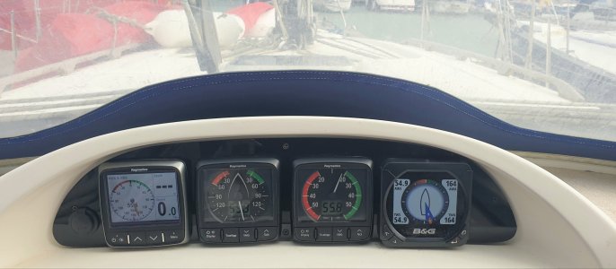

Although if you like the presentation style of analogue wind displays (with a real moving pointer), then see if you can find a Raymarine i60 Analogue Wind (or two).
They will just plug into the NMEA2000 backbone (with the right cable) and just work..
Yes, it really was a windy day...
