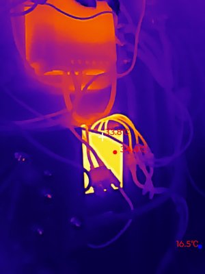

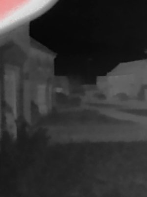

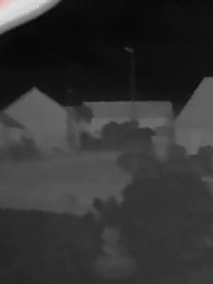

I bought a ThermalMaster P2pro for diagnostic work, which is a bit of a deviation from proper scopes. It works superbly at short range (inside the house) and I've been wanting to try it over distance too. It only has a fixed focus lens, so it should pick up things a distance away.
In fact I'll try it now as I've got a few minutes while my tea brews...
These are thermal images, not light enhancement. First pic is about 80m to the long building and second is a good 100m to the end of the road.
I saw a seagull fly past about 50m away.
These results are interesting enough to want to take it in to the boat for further tests 😁
(You can choose a range of colour interpretations, but this seems clearer than the conventional reds and purples, although on an uncluttered seascape, it might be down to personal preference).
It may or may not be any use for night vision, but it might be. Either way, it is very useful for the purposes for which I bought it though (if a little alarming seeing things looking as if they're about to melt - one drawback is that it calibrates the colour ramp on the fly, between the min and max in the image, so the hottest thing is always white hot nearly. I haven't found a way to change this, which is my only gripe)

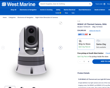

I'll take two, have them delivered to my Mayfair address :LOL:
Don’t need a marine one, they’re all waterproof. Start at £30ish on Amazon
I'd guessed that, but I knew the pukka ones weren't cheap and that 30k one was rather more not cheap than I thought.
It'd be interesting to see the results of an implementation of a domestic one though - something normal people could afford...
Don't you mean delivered to your concierge in Mayfair.
I thought about all sorts of better things, but needed to keep it short - it would actually have gone to one's man down on the Hamble or Lymington. rather than one's own address as one would certainly not be fitting it oneself...
