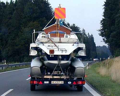

Marker boards for long overhang, or least for safety.
Yes, it has all that good stuff. The one in the photo I posted is not mine, it was just an illustration, but mine is the same. Last time it was moved by road it got pulled by plod and taken to a weighbridge and thoroughly checked over and measured. The only complaint was a bit of white light showing through one of the orange sidelights where the lens had been clonked, but that was just an advisory and was allowed to continue on the road.
Here you go, here's another piccy, also not mine, but with the long overhang marker board in place to make you happy :)
