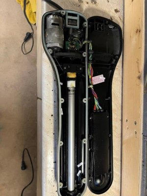

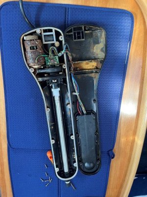

I thought I would exhume this thread (see 1st post). My then 15year old TP22 is now 21 years old, and my then new TP22 is now 5 years old. For various reasons the boat has been out of commission for most of this year - all now sorted, so went to pick up boat from the yard where the work has been done and got everything ready for the short trip back to my home marina (Woodbridge to Ipswich as it happens). Plugged in the 5 year old TP22 and zilch just some weak intermittent lights. OK, got the 21 year old TP22 out and all fine with that unit all the way home (singlehanded).
I opened up the 5 year old TP22 and discovered inside what was £500 5years ago is now a rusty lump of god knows what that had obviously been holding a fair bit of water inside. Motor seized solid and hall sensor board more or less dissolved. It has had a fairly easy life maybe out in the rain some days but no green water over the cockpit!
So Simrad/Navico, what an appalling piece of industrial design that is plainly not fit for purpose and now a useless P.O.S. with zero spares available for the insides other than a drive belt. And yes, I am aware of all the posts on here about water ingress in both Simrad and Raymarine Tillerpilots and really do wish I had used a waterproof bag over them but never had a problem with my old one. Simrad have a poor rep for fixing their kit so this is just a cathartic "get it off my chest post" really. If they sold spares I would have been happy to solder in a new motor and board. Now harvesting it for spares. Here are pictures of the insides of the 21 yr old and 5 yr old TPs.
21 years old and works fine.
5 year old P.O.S.
