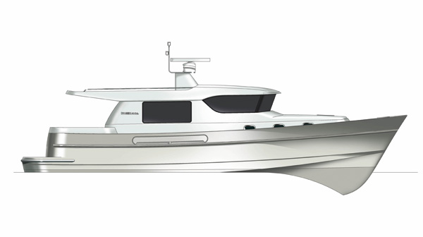

I'm liking the look of this...
MBY news item: http://www.mby.com/news/534934/new-40ds-to-give-hardy-a-modern-twist
That a very nice looking boat
Looking forward to seeing more artist impressions and layout options
I believe they have a winner on their hands as long as they come in at a competetive price

who needs a flybridge, we never have the weather for one of those.... ;-)
as far as the design goes, looks great. Really hope it does well, had a chat to one of the windboats directors a couple of months ago and he said there were new designs around the corner. Also planning a number of interior re-designs/modernising on existing models.. I hope good times ahead for a high quality British boat builder.
That's good, because as much as I like the bigger hardy boats (36 and 42 especially) the interiors seriously let them down. They need to look at what aqua star did with the 42 panoramic and up their game in a similar way.
The new 40 looks good, but I'd like to see an aft cabin version as this one seems to have very small accommodation for what will no doubt be a very very high price.
Very similar look to their new 62 so this seems like the new Hardy house style and I like it too. IMHO there's a growing market for boats that are as comfortable at D speed as well as SD speed but with a modern style and Hardy can tap into that market
