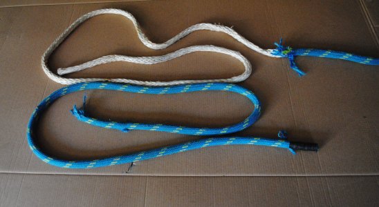

I will not go into the story. It is too long. But this Marlow 14mm dynema cored rope broke whilst placing a 2.5 tonnes mooring sinker. The break could have caused a serious accident, possibly death. We were so lucky.This section of rope was actually wound on a cleat & the core pulled out of the outer cover leaving the cover still on the cleat.
I have a Hanse 311
You say you will not use 2nd reef but a Hanse has a big mainsail & I always use my ST not the genoa. I find that for leisure sailing I reef fairly early & I use No 2 reef a lot. I do not furl the ST
I would buy the best Halyard. I have a Liros 8mm halyard because I dislike watching the sail crease as the halyard stretches in gusts. The extra cost in the grand scheme of things is minor
