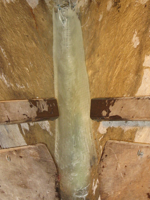

It was an especially awkward job I'd been dreading, and procrastinating, for yonks. FWIW, I'm putting a U-bolt down under the bow to help support a new alloy bowsprit, and I reckoned the 'V' bow needed reinforcing in the inside. "So what?" do I hear? But that specific place is VERY difficult of access. It's worse than caving, pushing a taddy-bottle ahead of you.
I can't get 'head and shoulders' through the narrow semi-bulkhead and cannot reach a hand right forward, never mind two. I've had to cobble together a range of grasping, roller and stippling 'tools' spliced to 6' poles, to position, present, and attach epoxy-saturated grp/woven roving strips right into the 'V', in all the right places and orientation, while maintaining line of sight. And for reasons I won't trouble to explain, it hurt. A lot.
No, it wasn't easy. And once started, I couldn't stop and come back to the job. Each layer needed to be applied before the preceeding one had 'gelled'. And it was messy. The dripping resin didn't quite get everywhere... but I certainly need a new haircut, and my sticking-out ears now don't!
But it's done.
The strings and things? That was part of an earlier complicated process of positioning some well-epoxied D10 GRP reinforcing thick sheet with Nyloc nuts bonded in 'right places' so I could drive hardware securing bolts down from the deck above. That, too, was a monumental faff - but it worked out. Another job I don't want to do again....

I DID wet-out the scoured substrate, as can be seen, but knew in my bones that any attempt to place dry w'roving strips exactly in place, then keep them there while stippling away like mad with a dripping brush cocked at an angle, on the end of a long stick, was doomed to a messy, hair-tearing-out failure. And so was the method I tried.... :mad:
More by luck than judgement, here's the result:
It'll have to do.
One can see, at the top, some errant remnants of the 'escapee' strands/bundles which defied persuasion, blandishments and cusses. Perhaps I'll go back one day and tidy up that part.
Perhaps.... :rolleyes:
