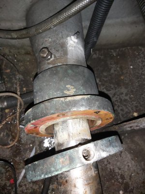

Can anyone help identifying this? from documentation it could be Halyard deep sea seal, but apparently they do not sell these anymore, any help to solve leaking, change the system etc would be greatly appreciated thanks Tony

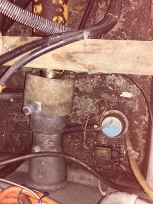

As above, what's in the weird cowl thing? Also, what is lurking under that bit of wood; just a shaft brush or something else? More photos please.

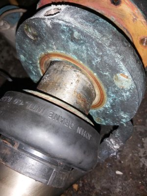

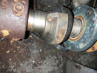

more photos if anyone can help

The rubber bit does look like a Deep Sea Seal but I've never seen the metal cowl/clamp ring thing before; perhaps the larger sizes had that to create more axial force on the seal face.

Lettering on it does say D.S.S Ltd so that would point to some variant of Deep Sea Seal
