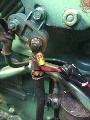

Firstly what does this bolt do on the solenoid. As I have snapped it on my other engine. Just wondered why it is set out like that is there away to rig it up without it.

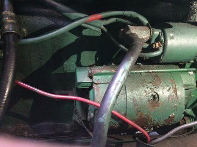

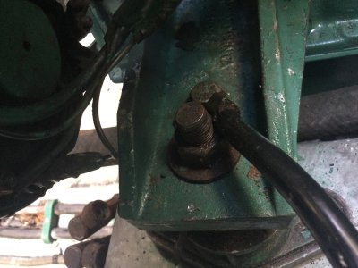

This big spacer between the red wire and black wire. On the other photos are of the other engine. Does that big black lead get attached to the red like that or should it be placed somewhere else. Is the earth conection to the other engine connected like that or does it go on the starter motor bolt any help is very much appreciated. Cheers danny

The plastic block with the two stud terminals is the trim pump fuse , some comedian has attached a feed direct from the starter motor or possibly used the feed for something else , to avoid a possible short or fire I’d be asking someone competent to look at it .
The big black wire is not from the starter motor and only reaches that erminal. I am trying to reverse engineer from the other engine however it doesn’t have this wir on it. I have tested it and it is definitely the positive supply. I’m stuck in France with just a crazy french man that don’t speak a word of our lingo for help.
One wire comes from starter solenoid the other goes to the trim pump , I’d guess the thick cable is supplying something else or it’s feeding the trim pump un fused .
Well. If the wire don’t go on there as it’s a fuse and it doesn’t go to the starter as that’s already there other than the trim power is there anywhere else it could go as I do not have power to the ignition switch on that engine so it’s obviously breaking the circuit where it is m
