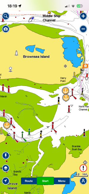

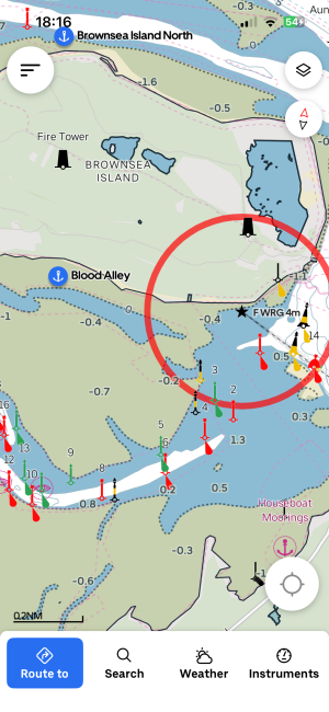

Have been playing around with the free version of Orca over the winter and like the functionality (and responsiveness of their help desk messaging set up, in aiding exploration that functionality). In two minds whether (currently) available charting detail is sufficient for primary navigation. May be partly presentational. Decide for yourself. These are Tresco Flats and Blood Alley Poole on Orca & Navionics as an example.
Orca
Navionics
OR
