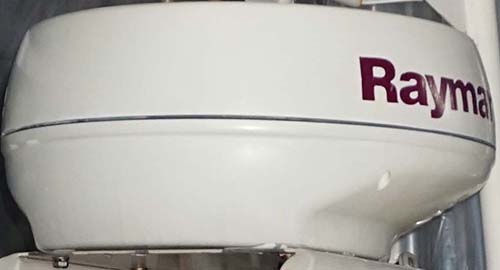

On the new to me boat I've got a 2004 vintage RL80C attached to the 2kW/24Nm radome below, and I've yet to understand if it doesn't work as well as it should, or simply doesn't hold a candle to the 36Nm Furuno I was used to, even if that was almost 10 years older.
Oh, and in case also mine would indeed be bust, am I right in understanding that:
a) there's no need to change anything if I should replace it with a 4kW/48Nm of the same generation, and
b) also the next generation immediately following mine - i.e. the one in the OP boat above - is fully compatible (again, both 2kW/24Nm and 4kW/48Nm)?
Before anyone suggest that, I'm not interested in an open array, because it wouldn't be worth redesigning the mast support (with its navlights, aerial, etc.) to accomodate it.
If you change to a 4kw dome you will need a heavy duty cable with dual power supply. You may already have this if you have a 15m cable installed to avoid voltage drop. RD218 & RD424 are both compatible with your RL80C.
Thanks, good to know that the RD424 is compatible. Considering that there are some used units for sale at decent prices, I might as well replace the existing radome even if in doubt about whether it's working well or not, just to get the additional range.

I have an old Furuno radome and cabling. The monitor / display unit was broken and it is irreplaceable unless 2nd hand. The problem being even 2nd hand it is both rare and expensive and there is no guarantee that the radome is still functional. So the boat was sold sans radar but came with the old radome still attached.
as shown
