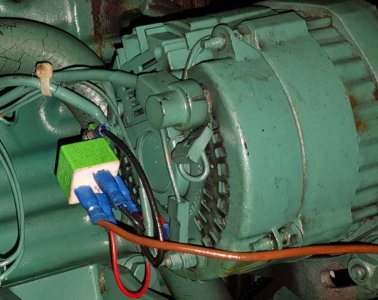

In trying to sort out alternator issue, I investigated a relay which is cable tied near to the starter motor, and I have a no idea what its is for, or even if it does anything.
Its not shown on the Volvo Penta electrical drawings, so it could have been fitted by Beneteau (it’s a French relay)

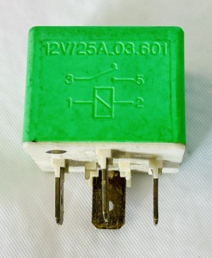

Relay is made by G. Cartier, 12V 25A, with type number 03.601.
Four spade terminals, 1,2, 3 and 5
Terminal 1 – Red wire connected to D+ on alternator
Terminal 2- Back Wire connected to B- on alternator. Terminal 2 is also bridged to Terminal 5
Terminal 3 – Black wire which disappears down towards the bilge.
Following this black wire it then runs parallel to a red wire, which has been cut, so it looks like at some point, this red wire might have been connected to the relay. The red and black wires have been taped together, but at the moment, I cannot trace the full length so no idea where it goes to.
Anyone have an idea what it might have been used for.
The way the relay is wired at the moment, it would appear to have no purpose.
