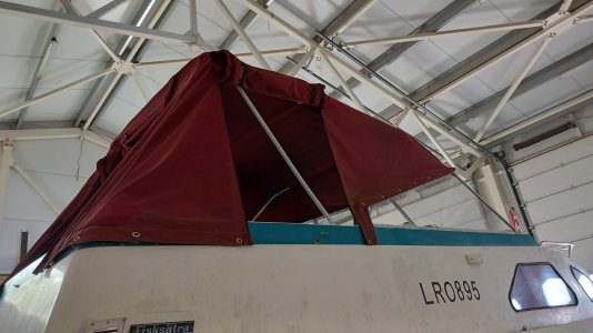

As title ... my Father used to saok tents etc in a solution to 'waterproof' them .. to stop water passing through - providing no-one ran finger inside of course when rigged.
My motor boat cockpit awning has just been repaired - new zips, doubling where frame wore through etc. But I noted today that water is passing through the material and cockpit is not staying dry as expected. There are no 'windows' in the awning ... only zips and dot and lift fasteners.
Is there still any solution out there that 'waterproofs' tents etc ??
