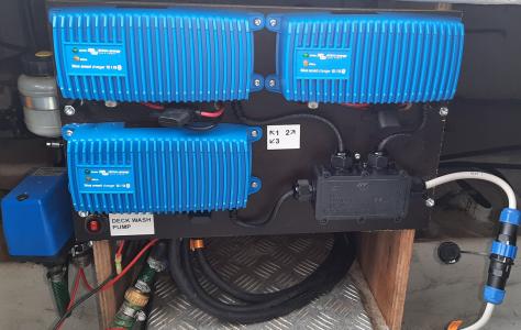

Just wanted to report back, after running the setup for some time:
Removed old charger from the cabinet by the helm (took some acrobatics, but eventually got it out).
Decided that the new setup should live in the lazarette, close to the batteries, and have their own fitment. Hence connected a certified installation 3x2,5 mm² cable approved for wet, submerged, underground and what not use from the shore power fuse box to the lazarette and fitted a 3-pin IP68 female connector.
Then fitted the three Victrons to a waterproof, phenolic plywood plate, and routed main cables to an IP68 connection box which had a male connector to the mains feed.
Each Victron's fused charge leads had a 2-pin 60A waterproof connector fitted behind the fitting plate, connected to each battery by 2x6 mm² heavy-duty rubber cables. All wires are labelled. The use of connectors facilitates easy removal of the panel with chargers if need be.
Must say it works beyond expectation. Each Victron connects to the app on the phone and onboard tablet, clearly monitoring each and providing data - of which the History displays with charging cycles and charged amounts is very useful.
