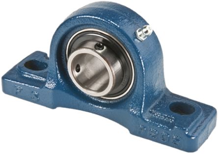

We used to use dimpled grub screws to locate belt conveyor shafts into pillow block bearings all the time.
You can see the glub screws in this pillow block bearing
