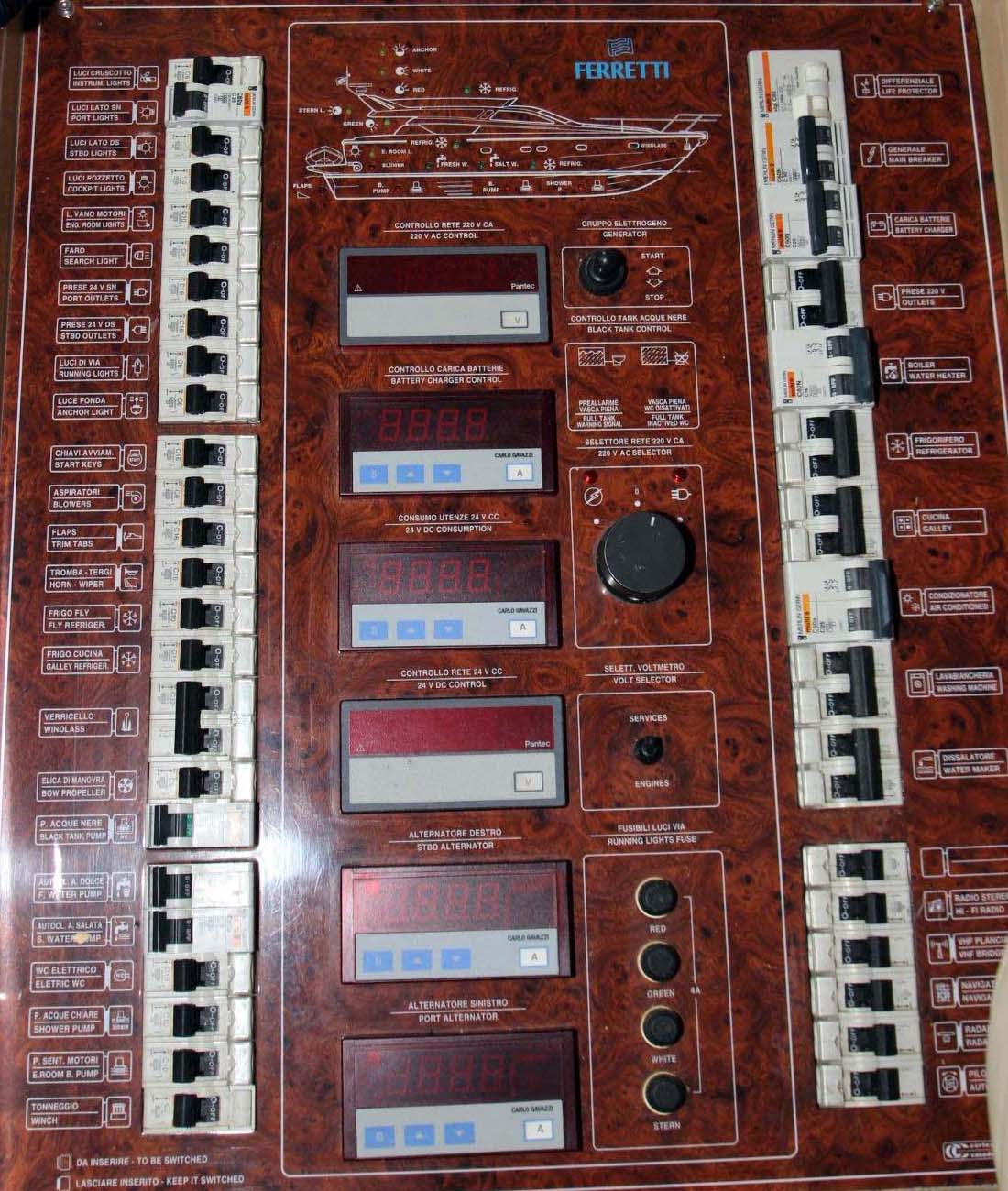

The main problem you would have, if your electrical panel is like the one below, is that there's nowhere to put it.
Which is the same problem I'm also having, btw.
But the thing itself is pretty small (you can see exact size in the Amazon link above), so hopefully you could find a spot somewhere nearby...
