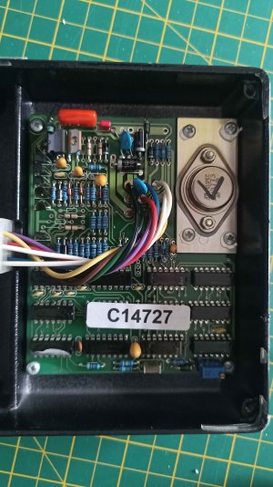

Meanwhile, I have just found this picture on the forum. Can you remember if the mentioned circular thing is on the top right?

The circular item with a "v" written on it at top right is a standard housing of a power transistor mounted on a heat sink. Underneath I guess it has three connections through holes in the heat sink. It will not rotate.
