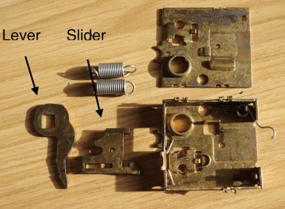

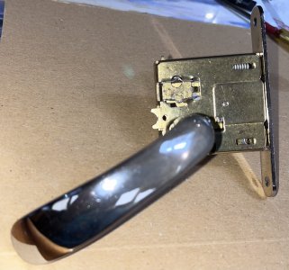

The toilet door handle isn’t springing back to horizontal position due to damaged spring.
I have not yet used brutal force to open up the inside of the lock. (Locked marked with Mobella and 102.)
On a Bavaria forum did I found a matching description but somfar have I no clue of the spring dimension (length, diameter, torsion).
I am looking for someone that has solved this before and can hint where to find the right spring. It would be a low cost if I could by it from Ebay.
The first image shows 2 springs, the lower one is the broken spring.

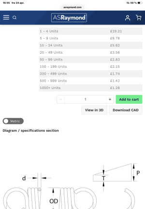

Another Bavaria owner with a B37 2006 shared which spring he bought from Asraymond and others trying to follow him noticed a very high price when you by a few springs from this spring retailer. Wire dia 1 mm x OD 9.1 mm x L 28.4 mm.

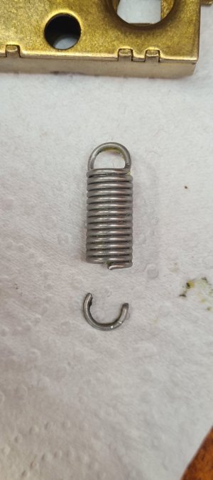

According to a sailor completed spring replacement the looped ends need to be at 90 degrees.

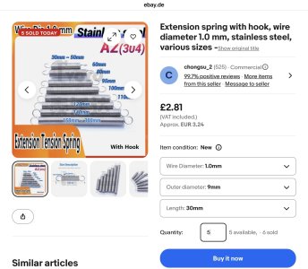

I have now read guys using several different spring dimension.
A sister yacht used 1.2 x 8 x 30 mm, it worked for him.
A Bavaria B37 2006 owner used 1 x 9.1 x 28.4 mm.
And the example you shared used 1 x 8.3 x 32 mm.
I guess it isn’t rocket science as long it fits inside the lock with some required tension for the handle ;-)
The link to Ebay product is very useful, the loop ends needs to be at 90 degrees have I been told but with some mild force that can be fixed.
