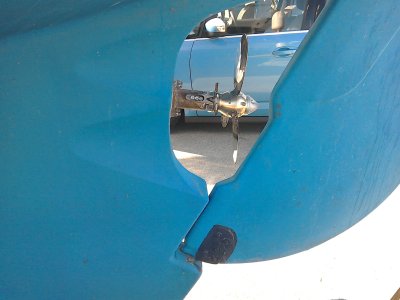

Sensible idea anyway to buy a Featherstream. Probably one of the best investments you can make, particularly on a boat like yours with such a large propeller stuck behind a long keel. something like this
