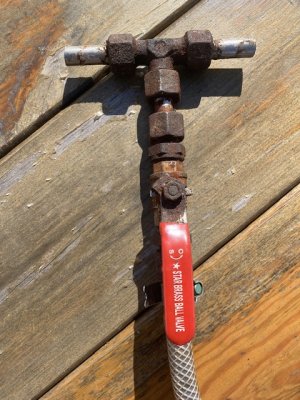

Here on a T piece which I THINK is intended to be used to flush the salteater cooling circuit by closing the seacock, and sticking the hose in a bucket of fresh water. Seems to be s mix of stainless steel pipe, steel compression fittings (quite rusty) and brass (domestic?) fittings, such as the valve. I suppose it would be worse if it all took salt water.
Ill clean it up somr.
Is there any suitable lube for the brass ball valve?
No, lever moves ok.

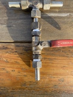

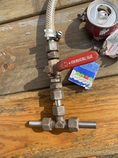

I buzzed the rust off with a coke can disk, separated most of the components, put PTFE tape on the threads, put it back together, and abraded it some more using boiled linseed oill as a binder. Given the mixture of metals I would have expected it to be worse, but I did run antifreeze in last year.
I expect I’ll have to teplace it with something more corrosion resistant once its exposed to salt
Is it worth getting all exited about something which is probably used once a year to flush the engine and exhaust with freshwater/antifreeze. I have something similar, which has been in use for 20 years without any problems. Different if it's a part of a permanent installation on the boat.
Well, the "top" of the T is the cooling water intake path, so it kind of IS a part of a permanent installation on the boat.

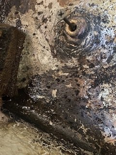

Theres a similar ball valve on the water intake through hull, which had not quite such mixed metals, though showing pink-under-crustiness that I took to be the dreaded dezincing of its bronze bits.

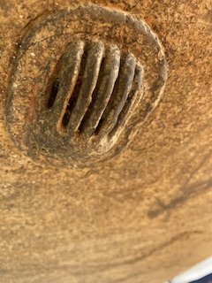

I similarly stripped it and worked some grease into the ball valve, which seems to operate smoothly. Actual through hull fitting seems to be glassed-in. Cant see how the external strainer is supposed to come off either.
The through hull has a wide hex nut holding it in the hull, which is either very shallow, and so hard to grip with a spanner OR its glassed in, which would be worse. The external strainer may be integral with the through hull since I cant see any fastners on it. This is the ONLY filtration on the.intake path, a deficiency I will have to address.
