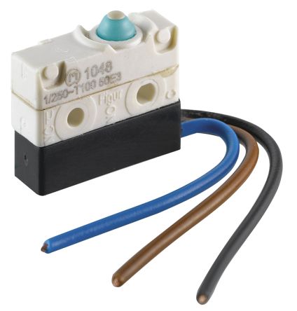

Thanks. I have looked more carefully and now know that I have a switch made by ITW with their codeAs well as the one I posted yesterday this might appeal to you
http://uk.rs-online.com/web/p/microswitches/8235289/
Has anyone found a source that will replace the microswitch that is within the lewmar deck switch
The little code number is 19N816PK. I tried Google without success
