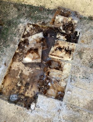

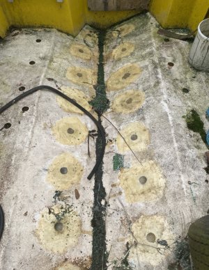

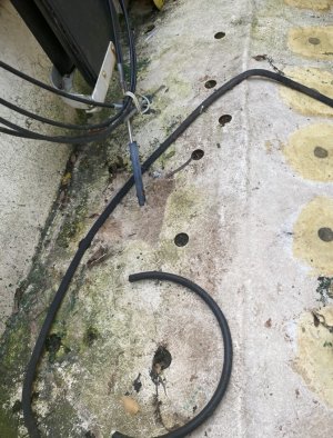

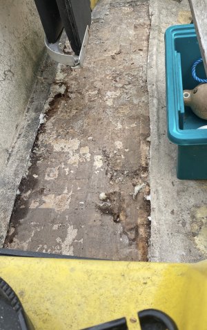

Hi all,
I’m a newbie to this forum. There will be lots more questions but….I rescued a Microplus 461 last year. The floor had a series of holes drilled in it. It was left uncovered for a while and as a result the floatation layer is saturated. I have started to removed the floor area and remove rotten balsa. There are no stringers, would it be recommended to install new stingers and fibre glass them in? Regarding the floatation layer, any advice on a replacement. Once this part is done I can move forward in this project.
I will add some pictures if that helps?
Any advice or guidance would be hugely appreciated.

That def looks to me like a balsa cored hull , if so you must replace the balsa core like for like ,same thickness balsa and re glass over with same thickness fiberglass , the strength of the hull will be seriously affected if you don’t, you can’t just rip the inner layer of fiberglass off scrape out the rotten balsa and a pop false floor over it and expect that to be job done , that would be suicide , the boats strength comes from the core it’s like having an
I beam , I’ve been replacing my boats balsa deck cores as it was rotten just like yours , if you any advice let me know.

It was made at the factory with balsa core it’s for a reason,it would also have been more labour intensive to make the hull that way , im sure if it was as easy as throwing in some extra stringers they would have done it when it was manufactured , the factory would have done a lot of stress calculations and testing , before to deciding to do it that way , If you only plan on using the boat on the canal then it might be ok to do it the way you want to do it but I wouldn’t want to buy it off you when your finished with it , and i certainly wouldn’t go to sea in it , also what you don’t want is hard spots on the hull ,all boats are designed to flex a certain amount, look at it another way I assume your trailer has some kind of rollers on it ? The bounce off the trailer going down the rod might cause crack to set up between hard spot and part of the hull that’s intended to flex a little bit ,hence think carefully about fitting stringers etc where they weren’t designed to be fitted,
it’s not as easy as saying “Dave” off Facebook says it’s ok to do it like that so it will be fine , just fix it properly and do the job once ,it’s not hard to grind down and clean up where the balsa was and stick some new balsa down with epoxy let it set and put few layers of fiberglass over the top, ok there are few more steps than that but you get what I’m trying to say , there are plenty of videos showing you how to fiberglass on you tube it’s not rocket science, best of luck Nick
Ps you could potentially swop the balsa for man made product like divinycell or pet foam I’ve done this in my side decks , but if my hull was cored like yours I would be still be inclined to replace like for like

I buy most of my fiberglass supplies from east coast fiberglass they sell end grain balsa ,
without seeing more photos of the cockpit floor I can’t really comment on the best way to fit a floor/sole , but you don’t want to do is screw anything into the balsa once it’s been replaced ,that’s prob what caused the problem in the first place water getting into screw holes , the new core needs to be sealed 100% or it will rot again ,
on my boat I’ve swapped the balsa core in the side decks to pet foam it’s not got quite as good structural qualities but it’s cheap easy to cut and doesn’t rot ,the side decks aren’t quite as critical as the hull so I should be ok 🤞 in your case this being a cored hull I would stick to what was originally used
