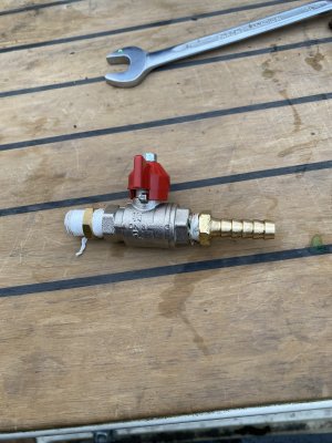

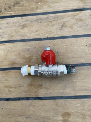

Thank you all so much, after removing the oil filter I put in a ball valve with a drain connection for a hose.
Worried in case the ball valve opens accidentally so will put the original 1/4” plug in place after each coolant drain.
