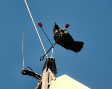

My Windex arrow has the arrow head part of the arm snapped off - probably by fat seagull trying to perch on it ...
I now have a stainless steel one to put up there later ...
To strengthen and stiffen the antenna .... you can get stiff thin wall plastic tube - slide that over the antenna whip before fastening the windex sitting onto the plastic tube ... BUT make sure its plain plastic - not Carbon Fibre !! CF will shield the antenna !!

Those windex combined antenna jobbies are hopeless
As indeed are the simple arrow type, rhat seem to break far too easily.
An opportunity for a new product?
A short flexible antenna at the mast headshould be high enough to work well? Or get a metz antenna.
Still need a much more robust wind arrow
Perhaps a softer slightly rubbery material that could abosrb a bird strike rather than a flimsy rigid plastic like the existing ones.
