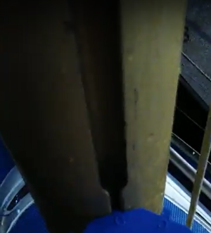

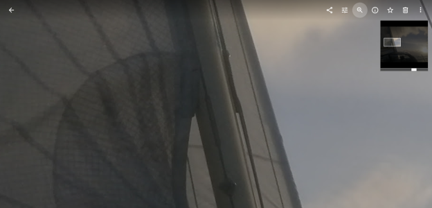

Was wondering what to do about it? I don't want a permanent solution, as the permanent solution (new masttrack) is going in soon-ish (still waiting on it after a few earlier hiccups). I will attach pictures, but I wonder what I can do to keep the sail slugs from falling out without making a big, huge job out of Do you think if I'd use duct tape, after the slides are in, and just narrow the gap the rest of the track, that it will be good enough so I can raise and lower the sails without having to handfeed the slugs? I know I could buy a stopper that would fit in, but it would be really high up when stowing the sail away. I was thinking to cut a piece of metal to pieces, but I lack materials for that and my powertool just died yesterday, too.
It only needs to withstand light weater sailing, maybe twice a week for less than 2 months or so.
Just seeing what input I can get here. Bit inonvenient that you can't just buy premade mast gates.
I am converting the whole system from roller-boom and boltrope to slugs and slab reefing. The system until now works with an open mastgate obviously, as there are no slugs.

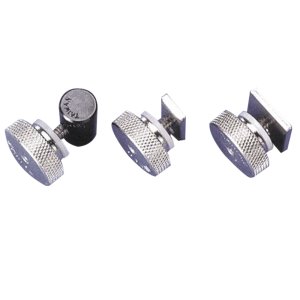

Plastic slug in the track held in place with a plate on the outside of the track and self tapped through the plate into the slug.
Into the slug? Do you mean like one of these stoppers? I do't like the idea because the mastgate is really high up. I am looking for ways to arrow the mastgate track (you know where it gets wide so you can insert and take out the slugs)Davis-Sail-Track-Stops.jpg

I made a couple of strips cut from a carpet threshold strip, Took a bit of cutting and filing and then had to be fixed to the mast which meant drilling and tapping the mast. In you case as your making wholesale changes, I wouldn't bother, just use a sail slug illustrated earlier and accept the high position until you make your changes.
