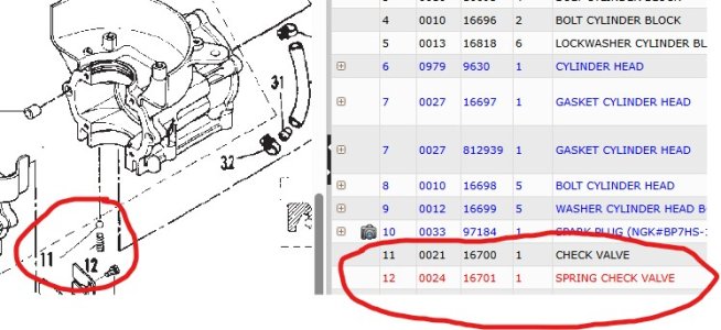

Sorry for Jumping on this thread but I am really struggling with a Mariner 4HP 2 stroke 1989 rebuild. I bought the engine for a song knowing it would need serious work and everything is going as expected and progressing nicely. I have one sticky problem.
Inside the upper drive shaft oil seal cover, ( directly under the cylinder head) there should be a spring and a ball bearing ( see diagram). It is labelled check valve. I have scoured the internet and I cant find these as replacement parts.
I have two questions.
What is its function ?
Is there an equivalent part number for another similar engine I might try ?
Any help or advice greatly appreciated.
Eric

AFAICS the spring is unavailable
The ball you will have to order from a Mercury/ Mariner dealer or find a suitably sized ball bearing
