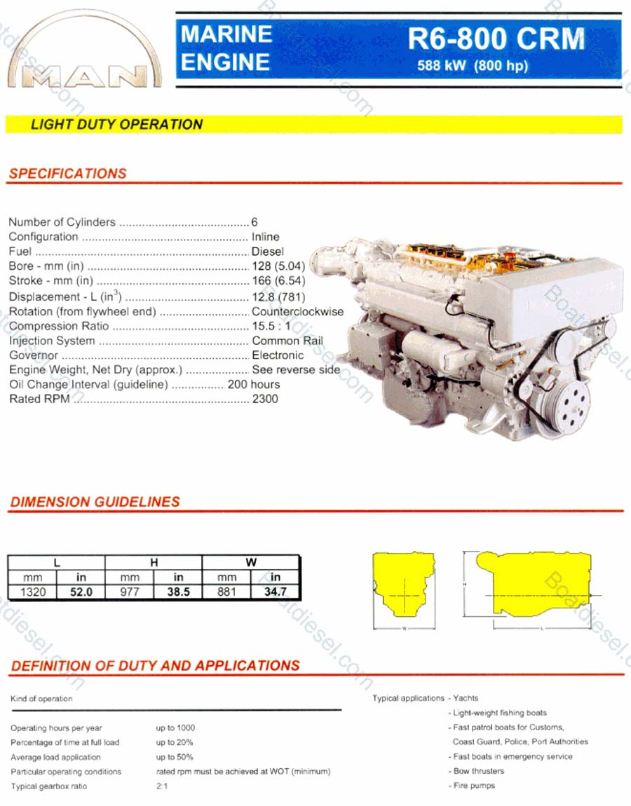

Hay what are you doing the bore is 126 not 128 in the link .
Mines 128/ 176 , that link is 126/ 166
Changed the bores , rods , pistons , cranks .
Kept the block and heads .
We all have brain farts :)

Guilty as charged for having misread the bore in that MAN webpage, but have a look at the pics below and tell me who's the brain farts contest winner, between Italians and Germans... Change bores, rods, pistons and cranks my @rse! :rolleyes:
Oh, not to mention that if your engines would be 128/176, their total displacement would be 13.6L, in my books.

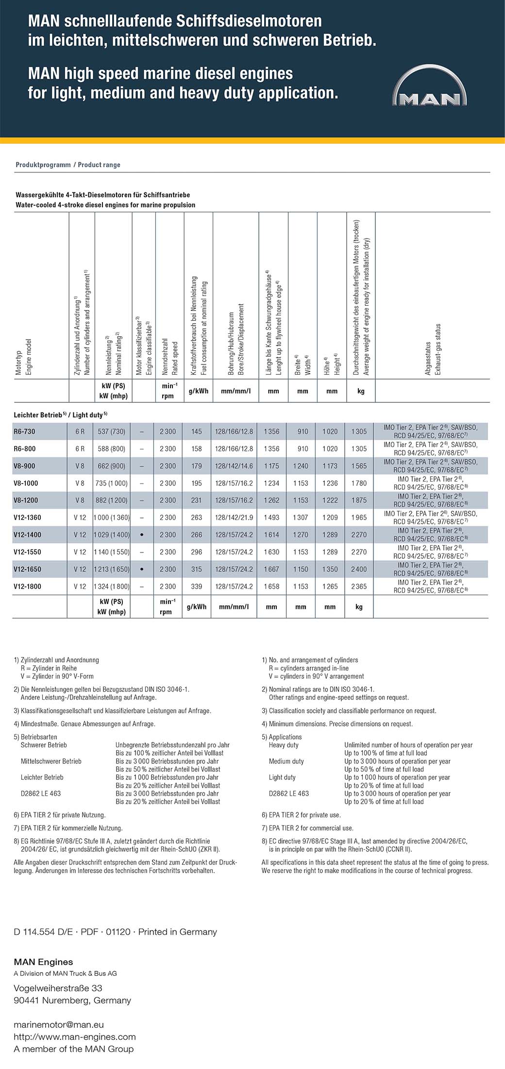

PS: btw, if you look at the table below, you can grasp what it means to REALLY change the stroke of an engine.
Just look at the weight differences between the V8/900 or V12/1360, which are the latest of the "old" stroke engines, and the other V8 and V12 with higher power - which is the evolution I mentioned in my post #12.
