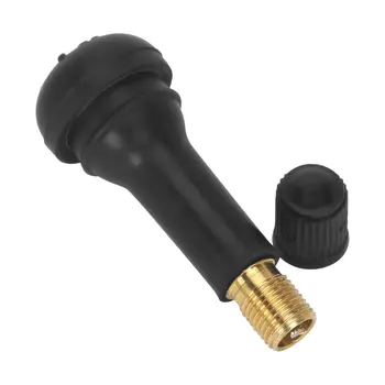

No I take an old tubeless tyre valve and cut the big end down until I can force it into a fender after drilling he old valve out.
I then put some PVC weld of even bostik clear contact adhesive on the hole and around the rubber part of the valve body.
I then push it into the hole making sure I don't push the valve body completely through and allow it to set for some time {a week or 2).
I then clear out the thread and insert the valve core. A plastic cap then protects the hull from damage.
I try to keep the valve a far in the fender as possible.
Most tyre fitment centres just throw then away I got over 50 fro free just by asking.
It amazing how many deflated fenders you can find where its only the valve is faulty.
Tis is also another possibility
One of these could also ke forced through and glued in place
Or cut one from tyre tube.
