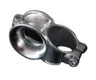

Fitted these now, having bought them a set off a forumite a couple of years ago, and they are excellent compared the decent blocks that were there before. They put the rope outside the stanchions so that the side deck is clear and they run on ball bearings and soooo much smoothe/easier to pull in.
I also have stanchion mounted low friction rings for other lines and they work well. Obviously they intrude into the side deck, and perhaps a bit more than blocks do, but the other advantage is that you can run a couple of lines through some/all if you need to and get big enough ones.

Honestly I'd go with whatever is cheapest for that use. It's a good use case for LFRs, small angle changes with thin and slippery rope.
No reason you can't have the LFRs right against the stanchion if you lash them with thin dynema wound around several times. Not as tidy as splicing them in place, but would do the job easily.
I personally prefer something solidly attached to the stanchion, when sailing downwind and the genoa rythmically fills and bangs the furler rope oscillates a lot, I tried blocks with soft shackles but they moved too much. I bought the Wichard steel ones, 10-12 euro each particularly inexpensive given the usually jewellery priced Wichard stuff, they work well.
I use a mix. LFR from the furling drum to aline the furling line with the first block. Last block is ratchet block (on or off ratchet) which makes easing out a reef a doddle when ratchet is on. LGR was bought from chandlers, stanchion blocks were from Harken. A very smooth system.
