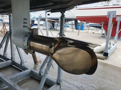

Our Flexofold (on Yanmar SD25 sail drive) is an engineering marvel! Just got to remember to pop the boat into gear when sailing to assist folding and less drag.

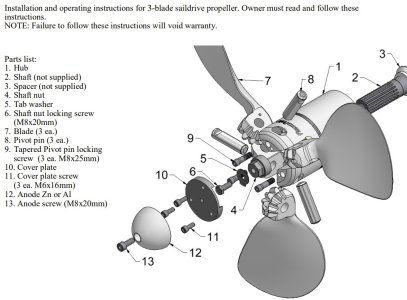

The securing method is good also - https://25334245.fs1.hubspotusercontent-eu1.net/hubfs/25334245/3-blade US SD33_2024-1.pdf
Item 9 in that diagram is a real pain. A friend of mine cannot get one out. The thing has a damaged hexagon so He has removed the saildrive complete & put another saildrive on with his old fix bladed prop untill we can work out how to get the screw out & remove the prop for service.
The allen key became slack so I warmed it with a blow lamp & belted it out of shape over an anvil. This made it tight in the screw but it sheared off in the head so we now have a stuck allen key in the screw that is corroded in the prop. It is a case of dissimilar metals. It would be advisable to loosen & remove from time to time to avoid my mates problem of corrosion. His was jammed up with barnacles which happened regularly- Poor design
Heat is your friend - or could be. With a different system but the same problem I had to resort to using a blowlamp to heat up the alloy. Because its thermal capacity was big, the blowlamp was left on a block of wood , heating away for 10 mins. Do it at your own risk but its the most likely way of seperating the two.
